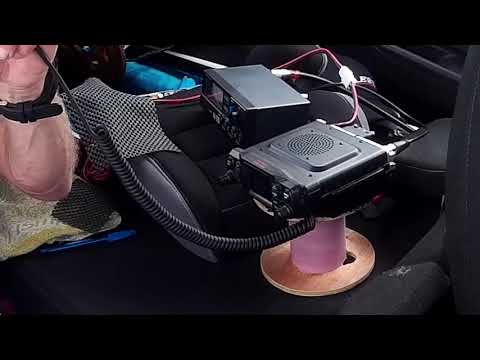

It was a bit of a challenge keeping things flowing , because most people could not hear each other and it was a relief when Lee and Lo’ got to Caldbeck and some of them could hear him well enough to work , but it was all interesting stuff, and I’m up for it again next time ,

It’s now shortened and the same as the ones I always use ( the 1/2 wave one I did most of the net with) so it will be OK. I was opening MX and getting an S7 return sig with it about 10ft above the drive and 5W from the FT-65. and GD and DG repeaters returning S9
