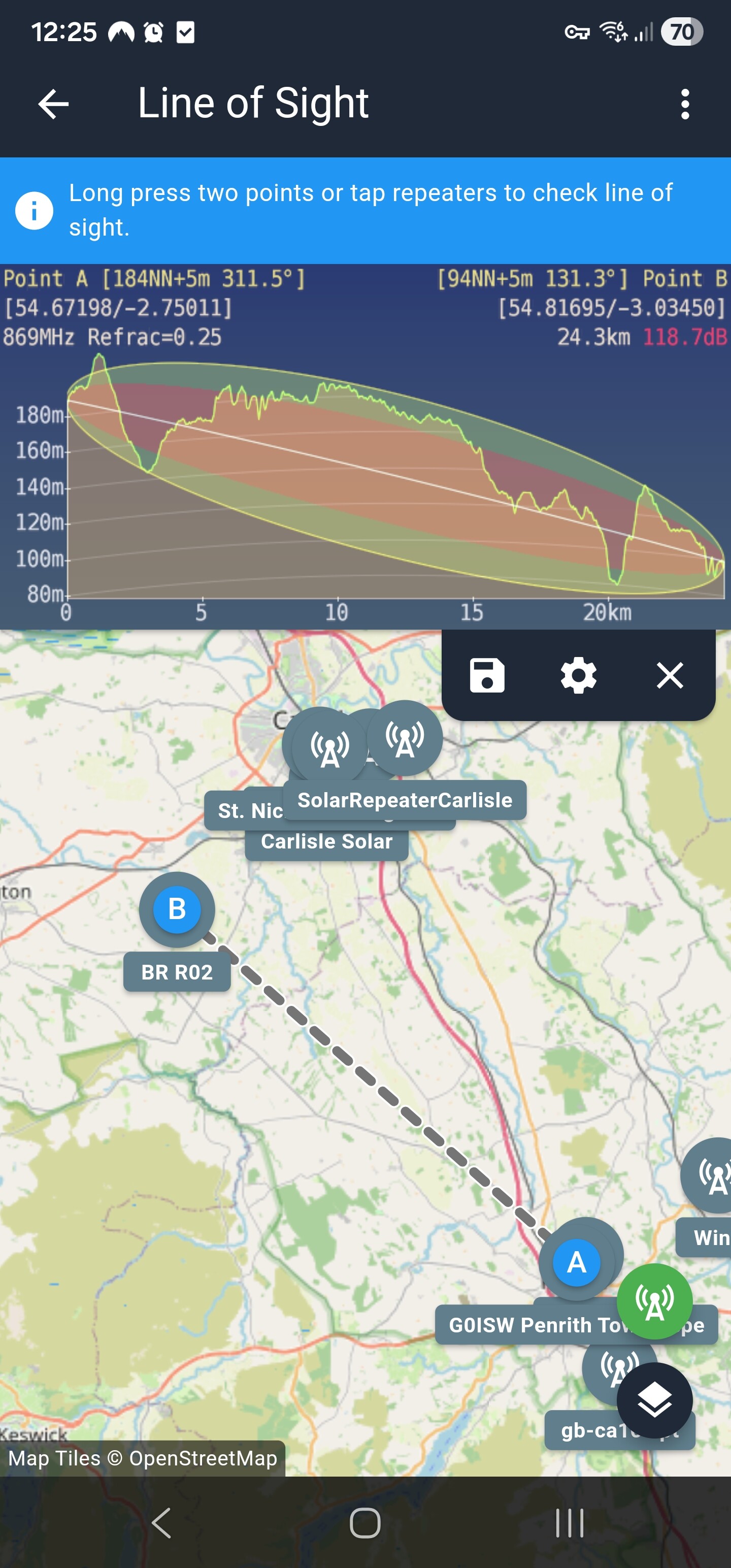

You definitely wont be able to aim directly at me from Penrith, the repeaters in Carlisle are my only salvation for a connection to the mesh, otherwise I’d be billy no friends.
Hi Dani, definitely not a direct path between us!
Can you be easily reached from all the Carlisle repeaters or is there one that is particularly good that I should try?

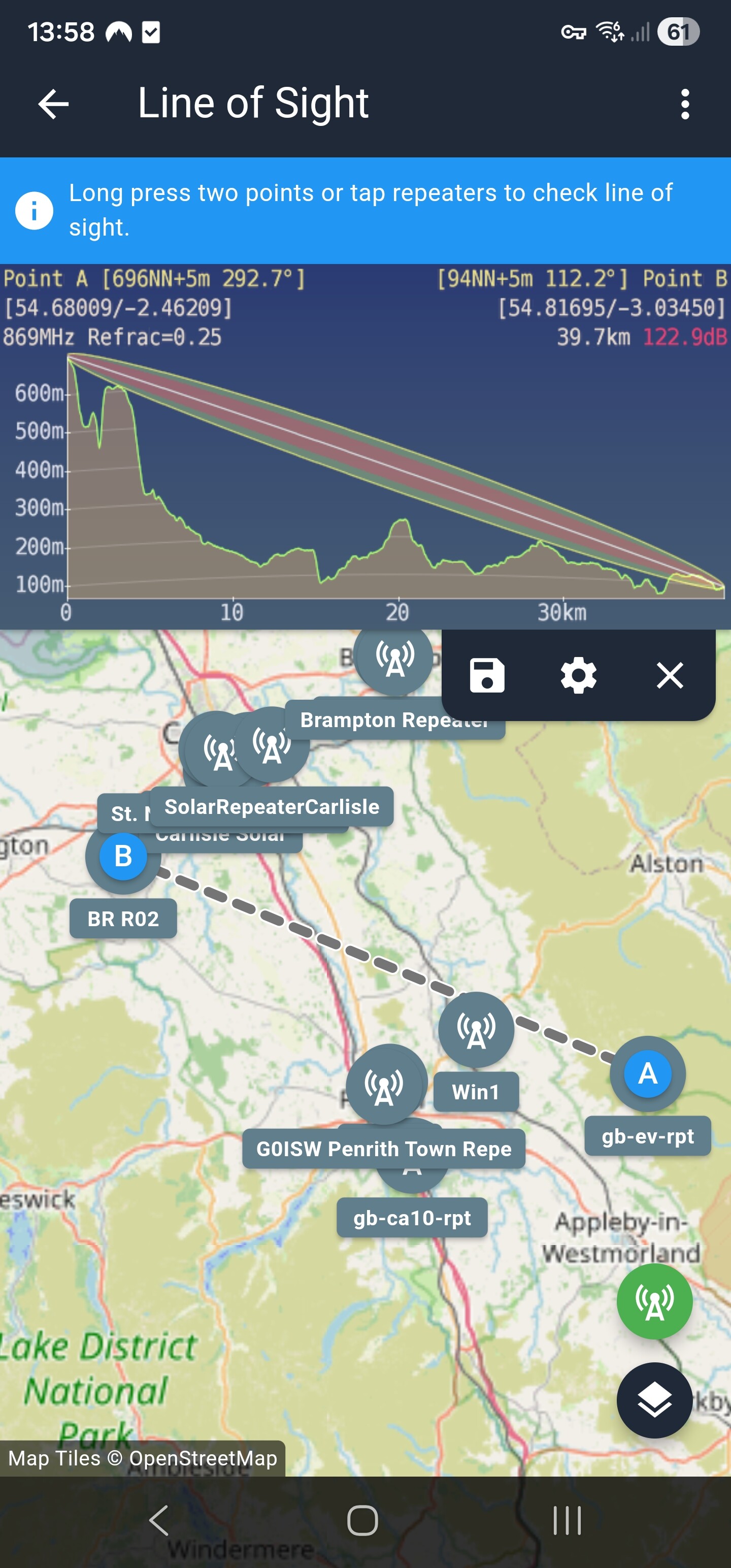

Im pointed at M1’s nodes including Carlisle Solar, so I’d aim about that area of you can.

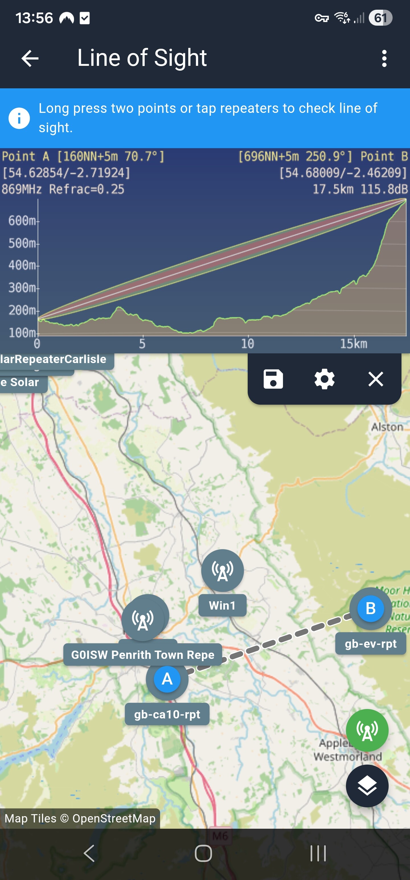

Another solution depends on what antenna gb-ev-rpt uses and which way its pointing
Im having a bracket fitted to the side of my house soon, much higher up than the antenna on my shed and will have potential to point at gb-ev-rpt.

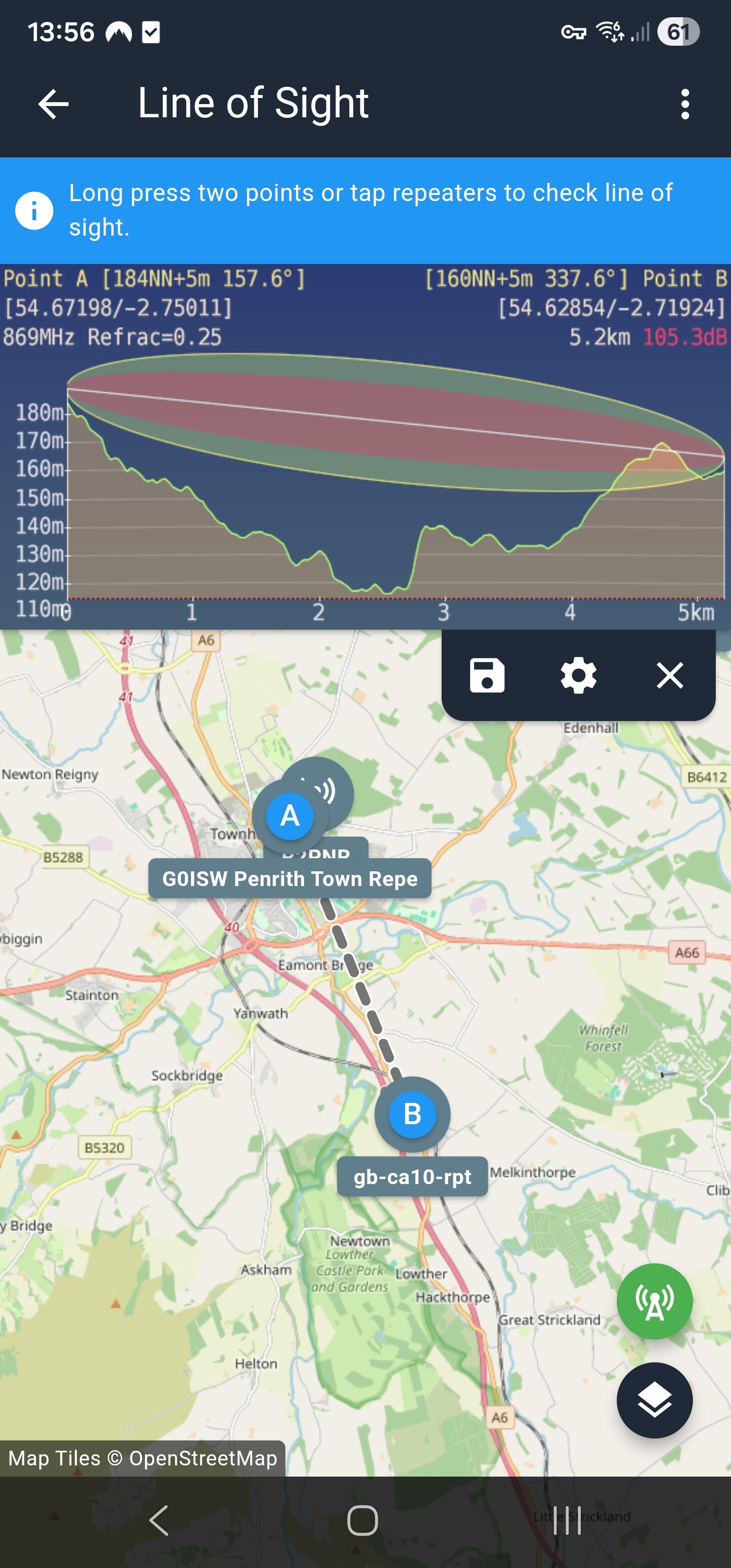

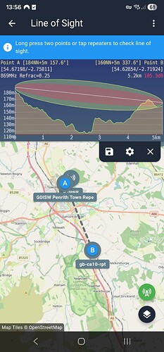

Thanks Dani, that is really useful to see.
I can get to gb-ev-rpt in 1 hop, not direct, via R1PNR or R2PNR. I will try to get from there to Carlisle solar.
gb-ca10-rpt is blocked for me as per your line of sight picture.
