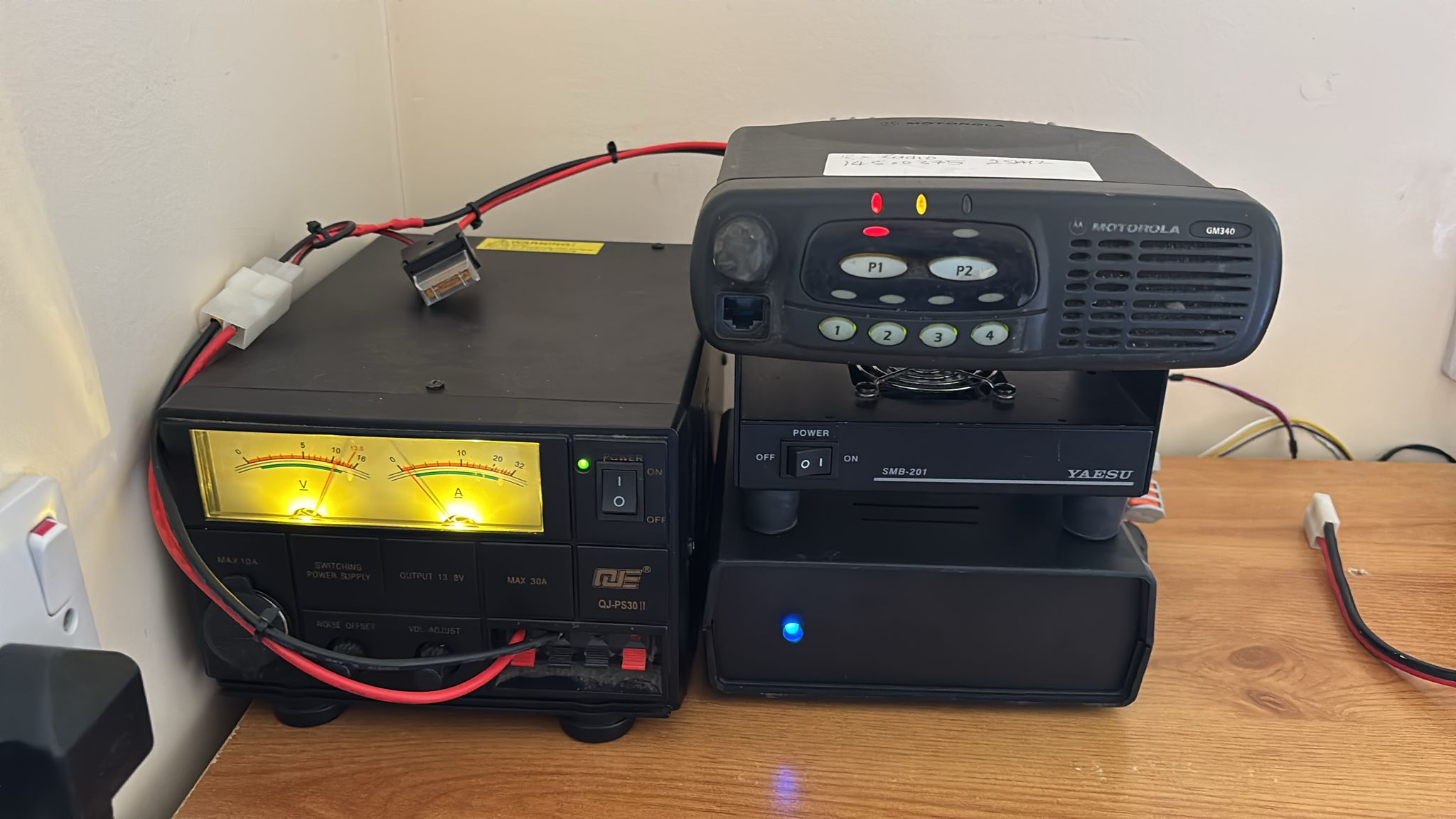

We’re pleased to confirm that Richard MM1BHO is currently hosting a remote RF node at his QTH using equipment supplied by us.
The setup consists of:
  • Motorola GM340
  • Raspberry Pi 3
  • Custom interface cable
  • RF link from CumbriaCQ into GB3DG
:round_pushpin: GB3DG is located in Dumfries & Galloway, South West Scotland, providing excellent coverage across the surrounding region.
We have been granted a 3-month trial by Raynet who own the repeater – many thanks to them for the opportunity.

:wrench: Current Status
The link is operational but we are addressing a few minor teething issues:
• Audio can be slightly noisy / crackly
• Currently FM only
• Repeater IDENT audio is passing across the wider network (this is being addressed)
• TX power was unintentionally left set low (0.5W) and will be corrected shortly
These adjustments should significantly improve overall audio quality and stability.
This is a trial period, so please bear with us while we fine-tune levels and settings. Audio and signal reports are very welcome via the CumbriaCQ network.
Huge thanks to Richard MM1BHO for hosting and supporting the project :clap:
