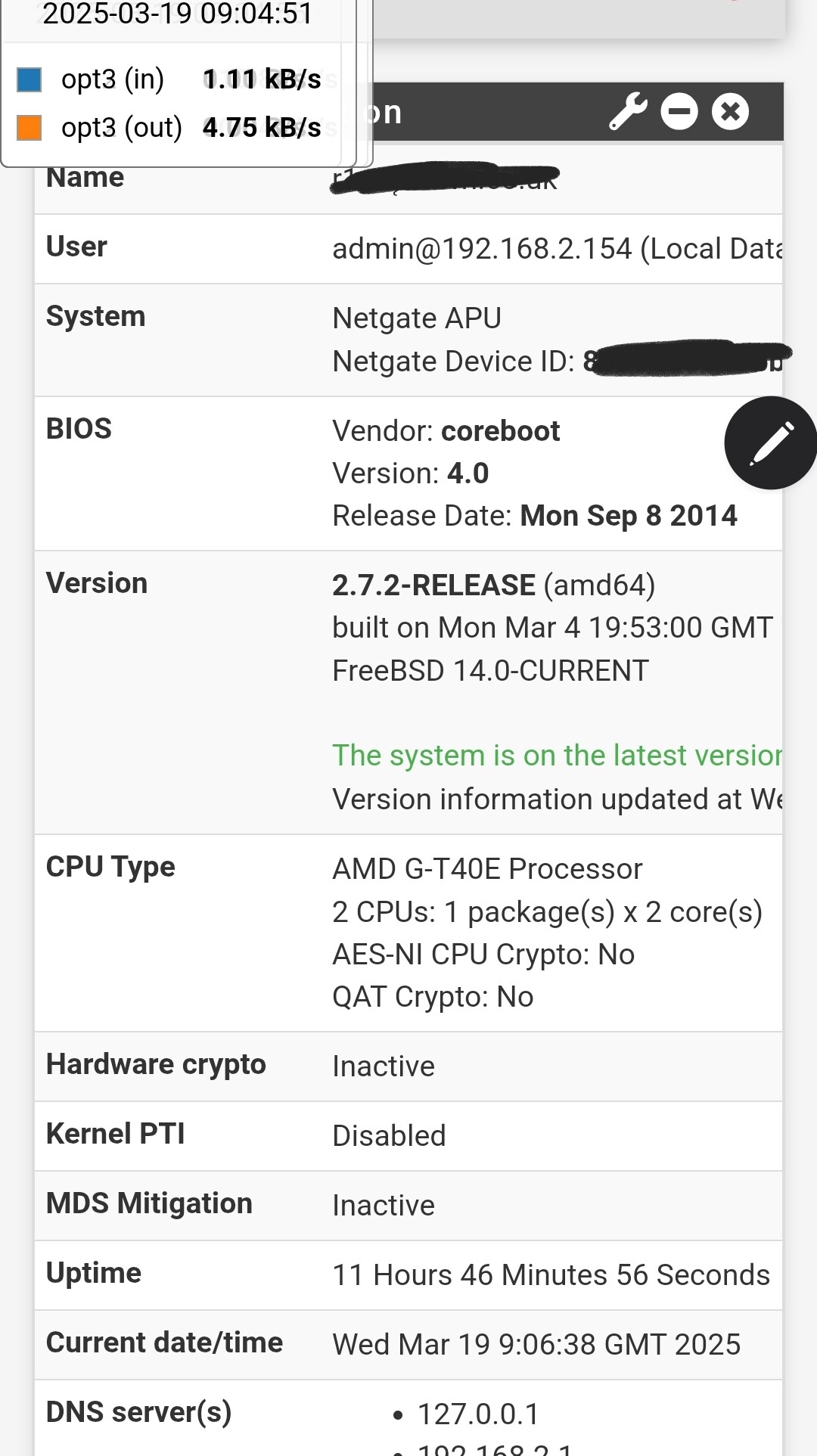

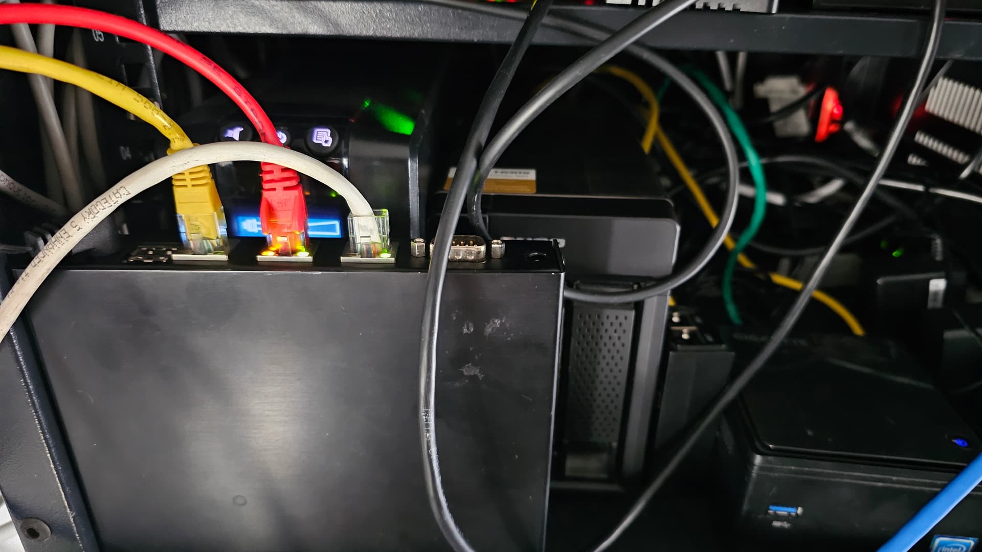

I ditched the DrayTek and built an open-source pfSense router using a mini PC with 3 LAN ports and a serial display. Installed pfSense via serial console using PuTTY (old school style!), and then… I had to rebuild my entire network from scratch.

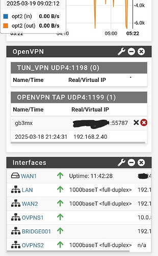

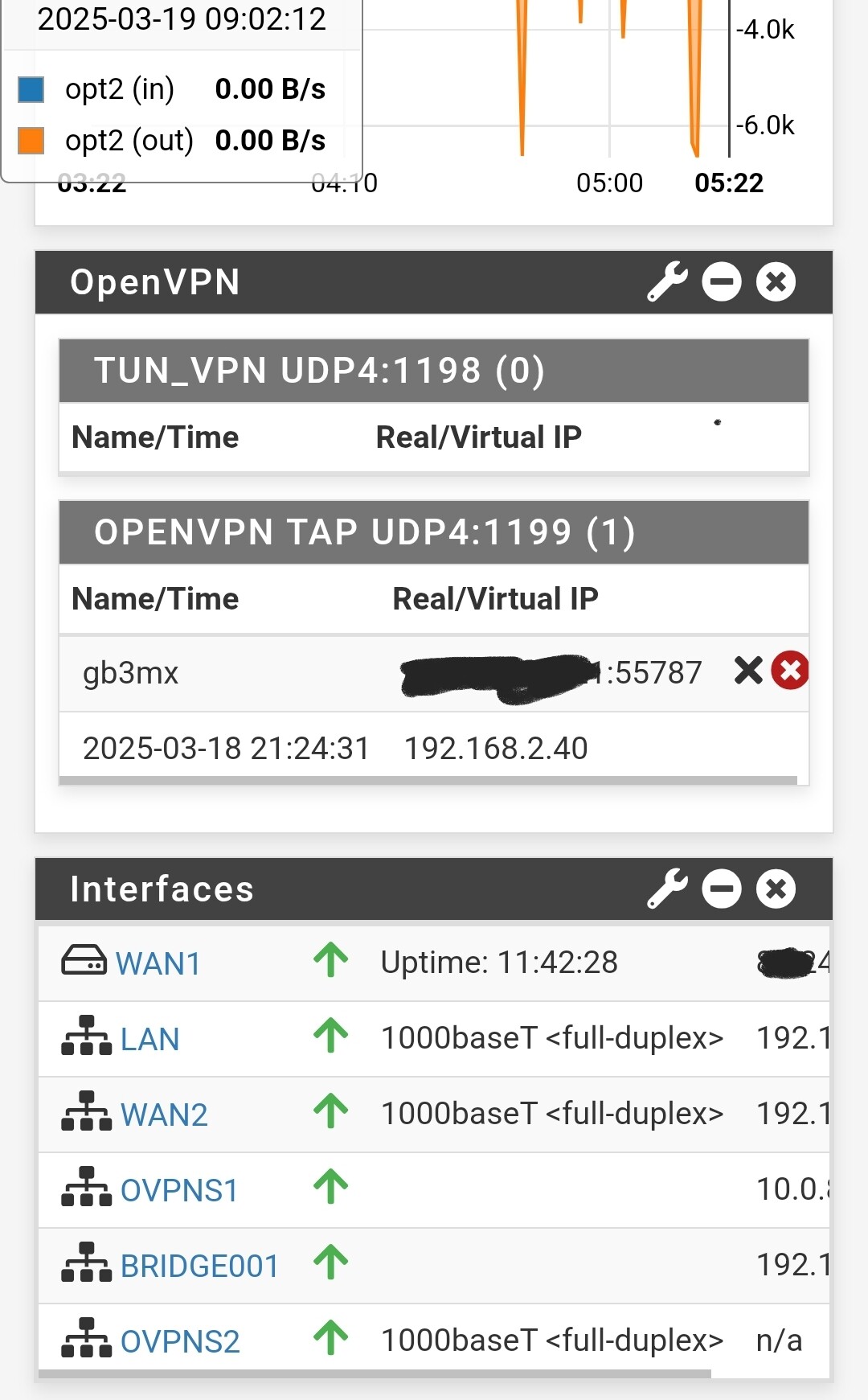

  • :closed_lock_with_key: 2 OpenVPN servers

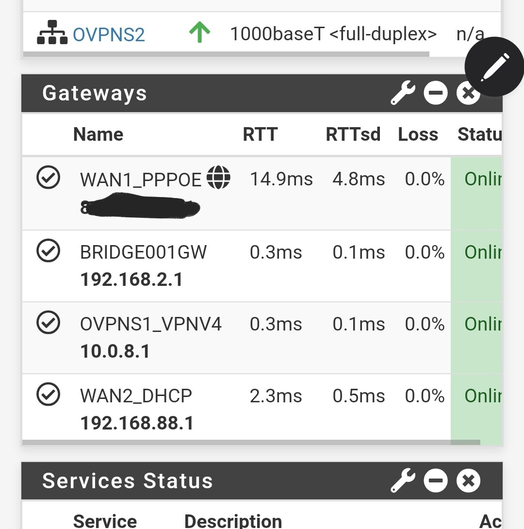

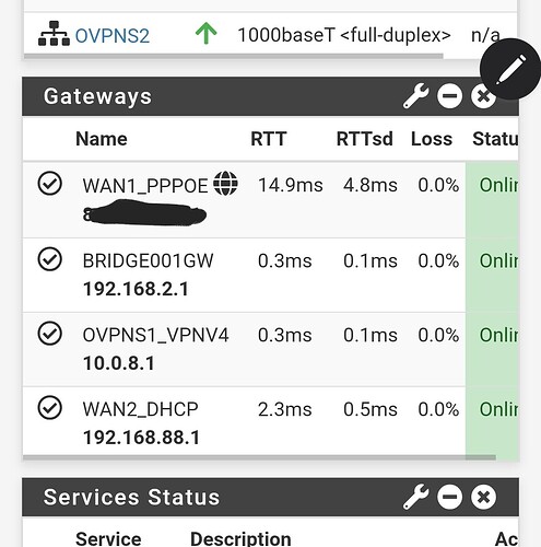

  • :globe_with_meridians: Dual WAN setup (I rely on both for work)
After 3 intense days of network wrangling, VPN over TAP is finally working flawlessly—and GB3MX now behaves like it’s hosted locally, even though it’s remote.
