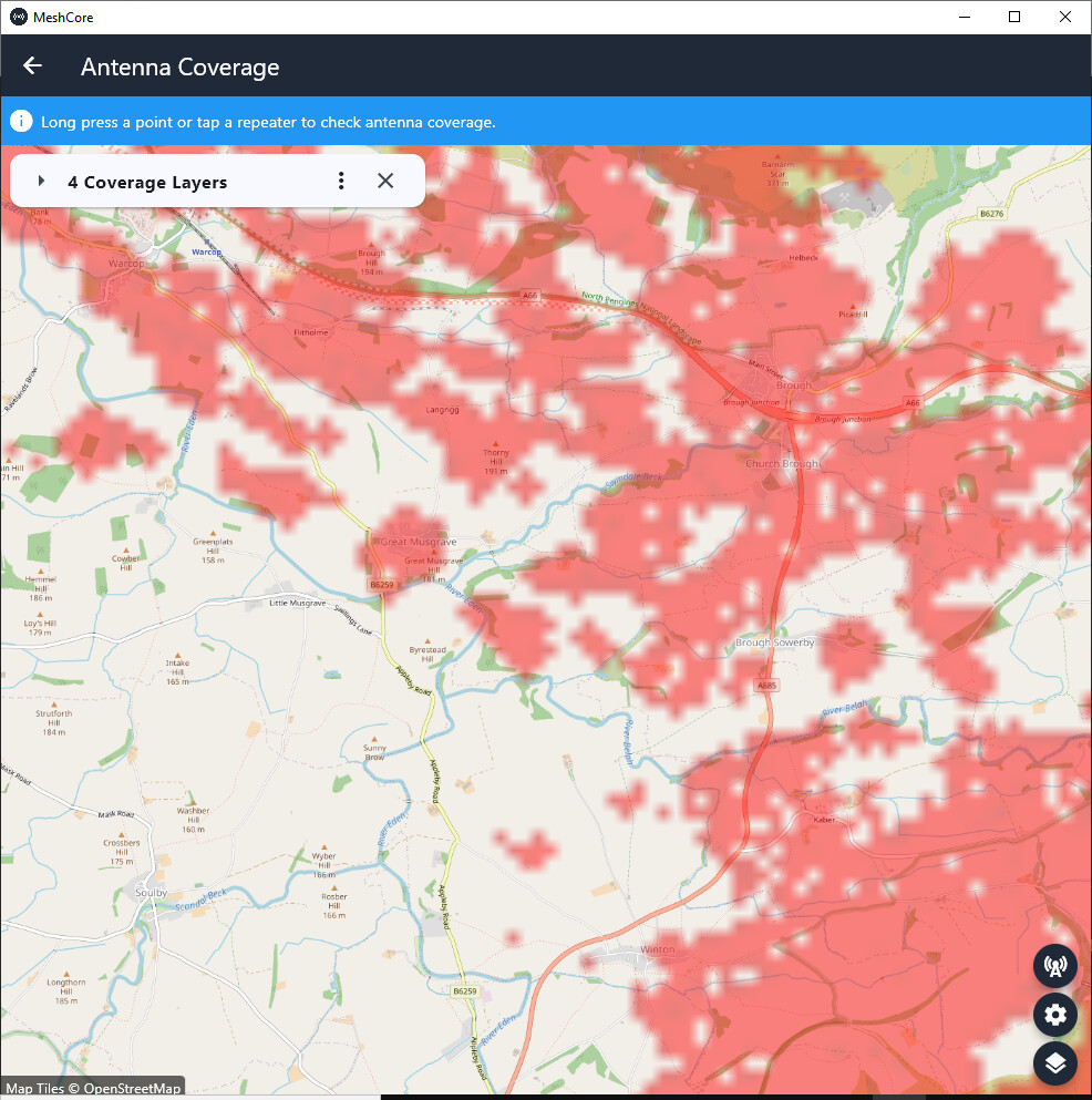

Whilst you wait to get on MeshCore you can use their online app from PC to view a map of this area and using the tools tab plot antenna coverage from any point or line of sight between 2 points. https://app.meshcore.nz/
Map>tools>antenna coverage then long hold down mouse cursor to set a point and watch it draw
I have been this morning looking at further potential sites for a repeater and will need to do some dog walking to covertly locate a suitable mounting point
You could try this for your location and see where might be best for your own setup and where would not be so good to reach existingb MeshCore Nodes (repeaters) https://map.meshcore.io/?zoom=11&lat=54.6144&lon=-2.6086
There is a node shown at Winton, quite close to you, from 28 days ago, but I am not sure if it is still active or not
hope this helps

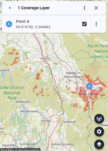

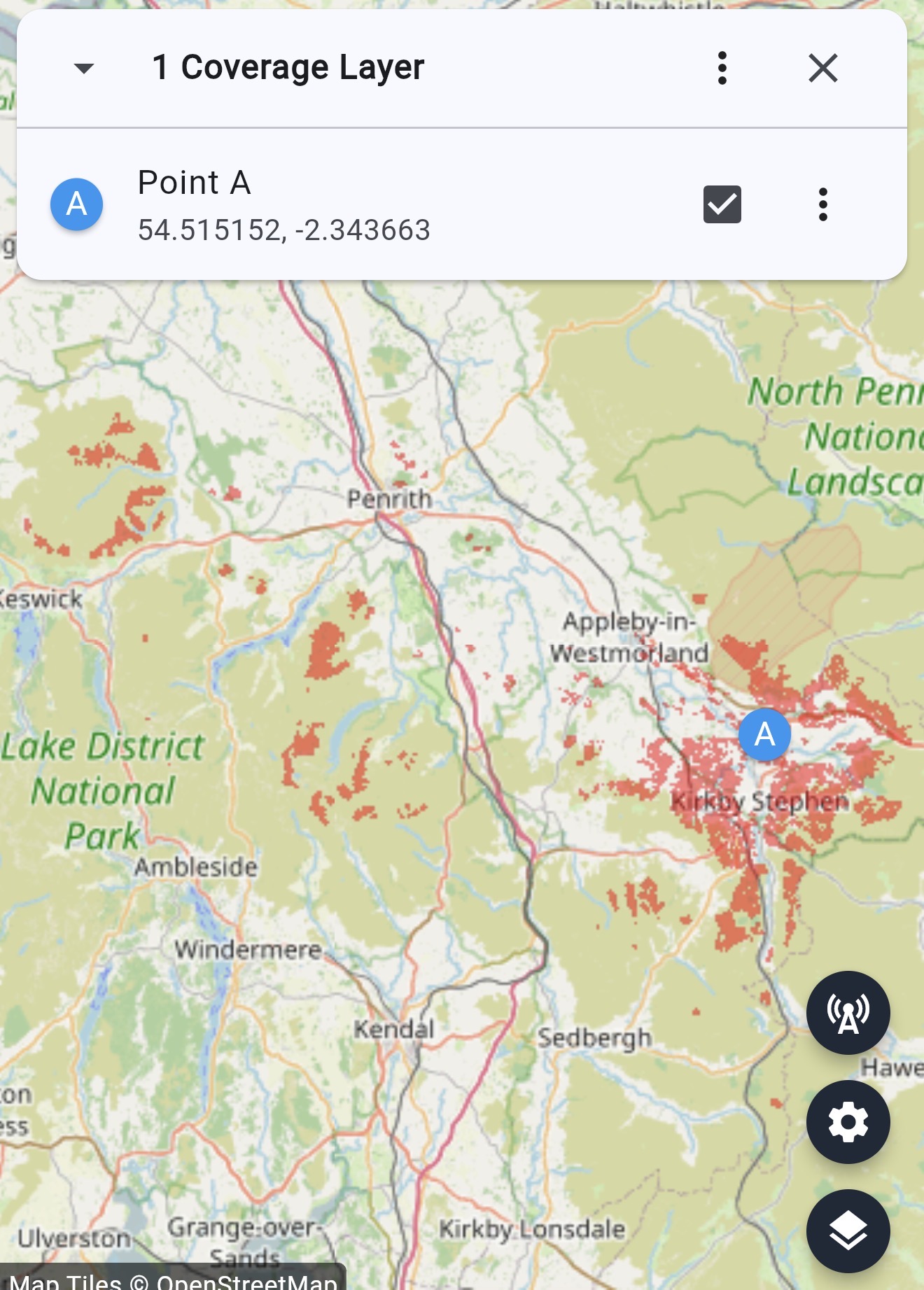

A cracking tool.
Annoyingly, I’m in a white bit surrounded by red! However with a repeater 10 to 15m up I should be Ok.
Hi Nic,
I can see some of your red area coverage hitting the higher ground of Penrith, which is encouraging. I found yesterday that even moving the location of a node/repeater 50-100m can make a world of difference for coverage on the tool map.
Thinking ahead you may have your companion device with you at home in the low white area, but potentially you might have other options for your repeater on higher ground on your farm?
Potentially when some of us move our own repeaters, fairly soon, we might significantly improve signals in your direction.
