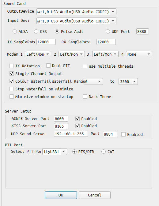

For simplicity download both and run the soundmodem. The setup of devices is specific to your rig but here’s mine.

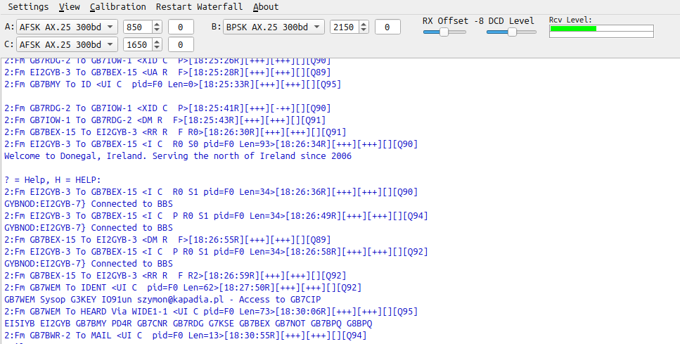

The modems can operate independently so you can have up to 4 running at once. For the HF setup have one as BPSK AX.25 300bd with the audio at 2150.
Tune you HF rig to 7.04945 USB (Data) and make sure audio levels are in the green and you should start receiving packets like this.

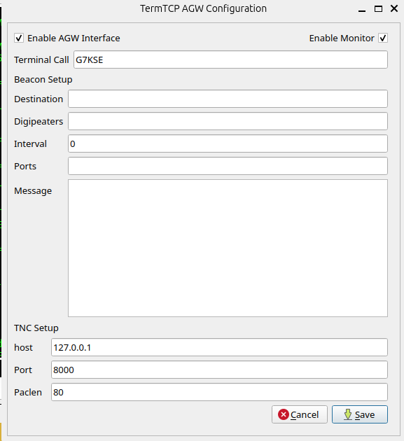

To connect to a node we need QtTermTCP. We’ll use AGW that we set up earlier

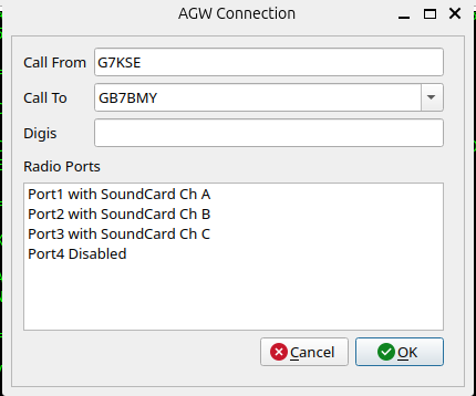

It should say AGW Connected in the bottom right hand corner. I have terminal only in the window. Click connect and enter in something like this
If you’ve setup like mine then Port2 is the one to use. If alls well then your rig will transmit and GB7BMY will respond and you’ll connect.
