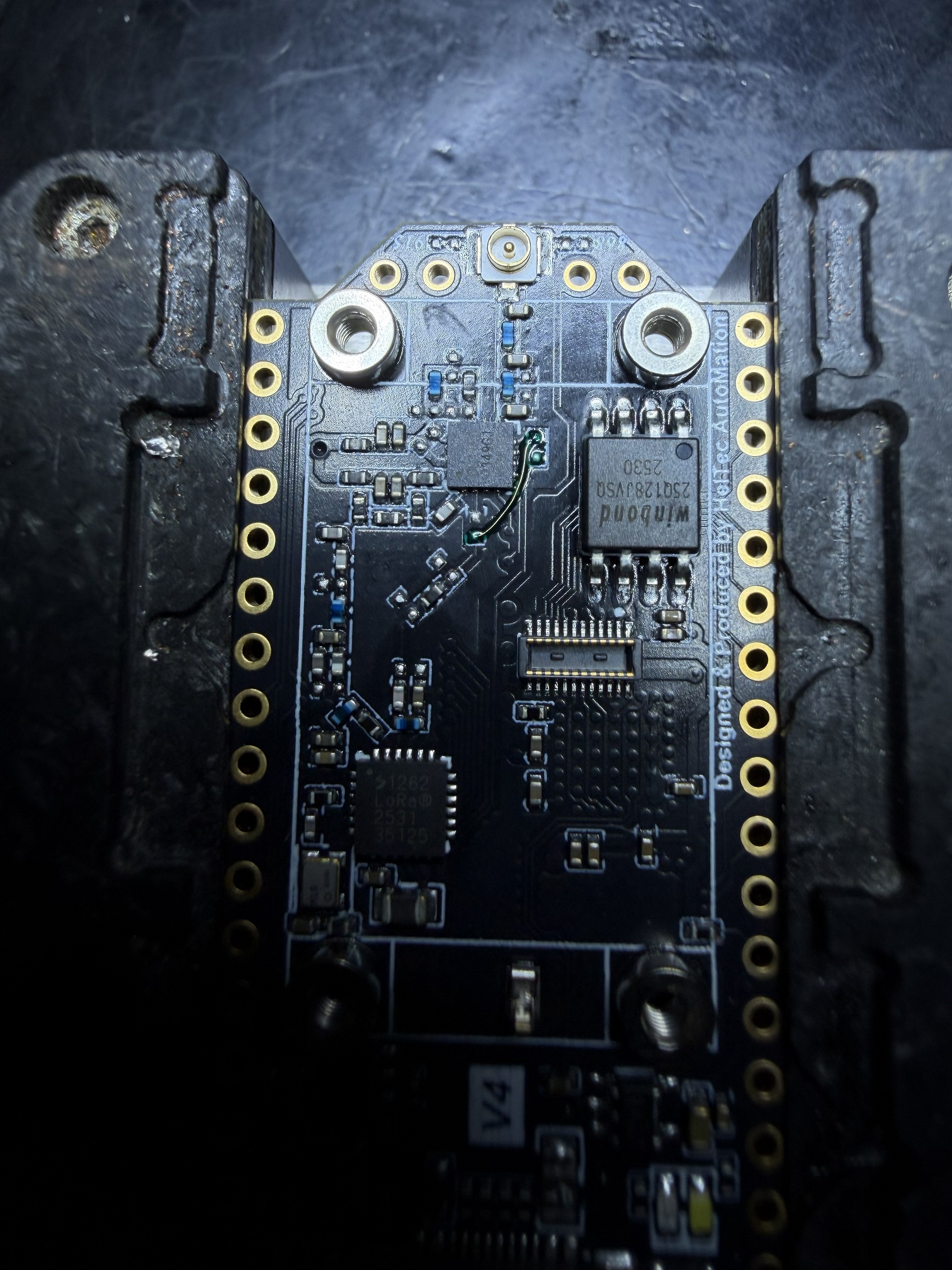

Tests so far .. the patches don’t seem to of made any difference to the v4 deafness, however if your into smd working, then there is a v4 mod which I’m going to have a go at that bypasses the lna or something (which is the cause of the ‘issues’) remove 1 cap 1 resistor and fit a jumper wire, what could possibly go wrong, :roll_eyes:
For the curious, remove the 4 screws holding the display and lift it off….. then go compare
You ‘should’ then have the RX of a V3 (lower noise floor number) but with the extra TX of the V4
P.S the above piccy is not mine, and its not my work…. I can only hope to get close to that

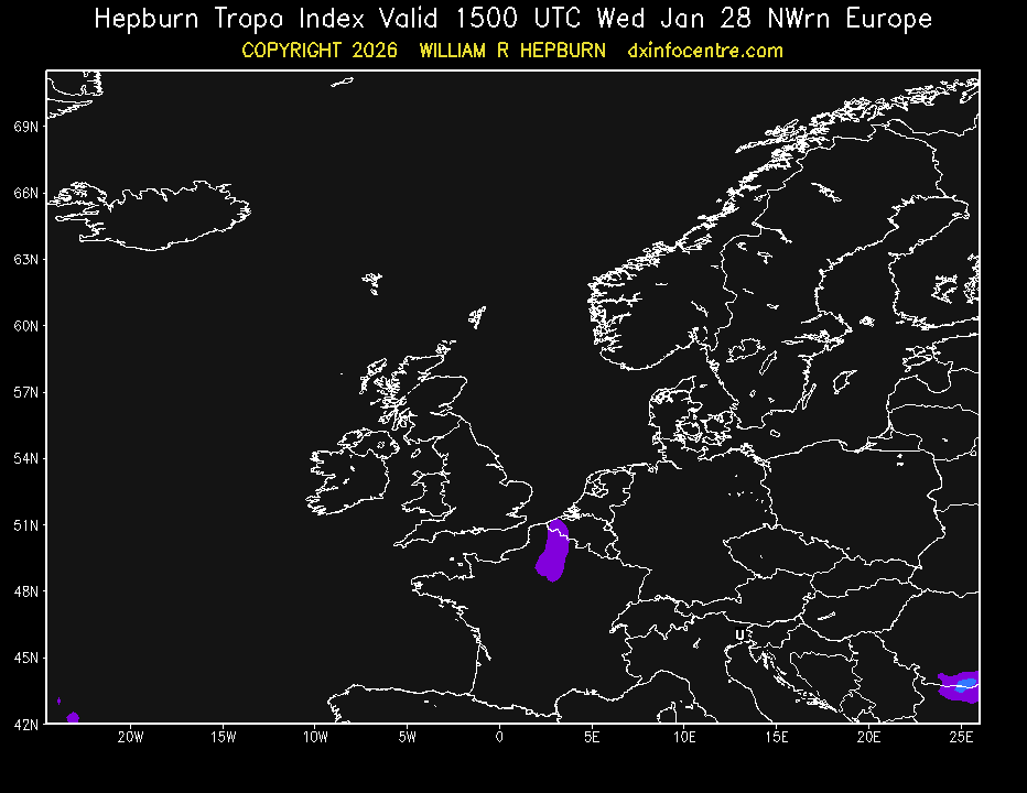

still seeing your messages though. lets have a look at the tropo forecast… it’s interesting because nothing is showing on the map really.
Hmmmmmm…… welcome to the world of rf propagation, where the only predicable thing is the unpredictability

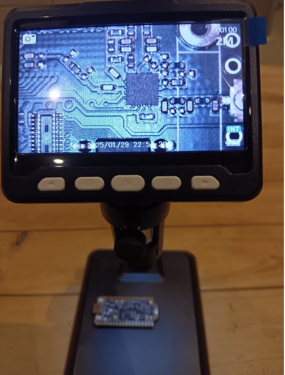

Anyway .. apart from that, the microscope turned up this afternoon and wow, its not often I make a good decision :roll_eyes:
£26.99 from Amazon, Digital Microscope, 4.3 Inch Coin Microscope 1000X, 1080P Compound,Coin Magnifier with 8 Adjustable LED Light, PC View-Microscopy Black: Amazon.co.uk: Business, Industry & Science
That’s nowhere full zoom, but the higher will only show the soldering iron shaking in more detail, so this level seems to be a decent compromise, got to hold the board down with blue tack and its rock and roll, could use the hot air…. but its kinda tricky and has other issues.
wow that looks good eh and great for the price
Indeed, its perfect for the task at hand
But …
There’s always a but, lol
For general pcb usage there’s a couple of caveats
  • the base is plastic and will melt if using hot air.
  • the distance from the back (height adjuster pole) to the center of the lens is only 1.5” / 40mm in new money.
A little bit of imagination or thinking inside the box can solve these problems , Maybe take it off of the base and gaffer tape it to an angle poise lamp, lol
Progress report
1st one done.
In a silly indoor comparison the noise floor is lowered by 16db (from -102 to -118)
Was it an easy job I hear you wonder, well not really … unsoldered the 2 components and promptly lost them, never to be seen again, the .2mm wire was a bit to thin and wouldn’t stay still whilst soldering, so I’ve ordered some .5mm for the next one.
Is it a clean and tidy job ? no, what with having issues soldering the wire I overheated and lifted the track going to the chip, so ended up soldering it direct.
2nd one in a day or so
Well, 2nd one got done and working…. errrr rather like rinse and repeat, lol
Will definitely use hot air on the next one, and the heavier gauge wire was not a good choice, lol
does it work ?
Yes, it works fine and noise floor is lower…
Just the jumper wire is untidy and that offends me, mind you back in the day my hands were steady and I never looked at my work through a microscope :grinning_face_with_smiling_eyes::grinning_face_with_smiling_eyes::grinning_face_with_smiling_eyes:
