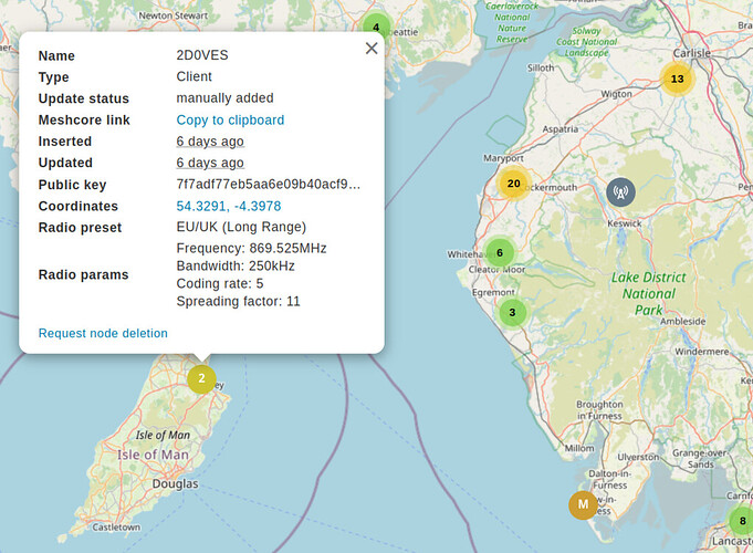

nodes in IOM (on the wrong frequency) Anyone able to set a spare node up to LongRange and make contact to get them on the right frequency?

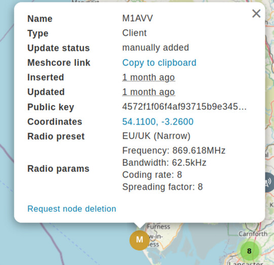

and the node in barrow is on UK Narrow anyone heard from them?:

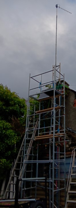

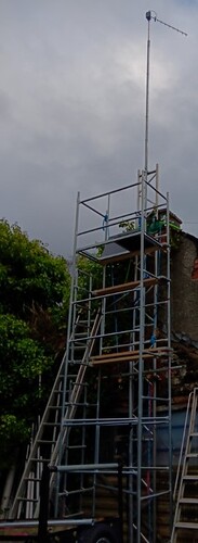

Latest from the tower of power 'ish
So far Yagi is at 9m above ground (28 asl) with an easy possibility of another 3m
The eagle eyed may spot that I’m using a 2 pulleys which makes the weight easier to manage (2 pulleys = 1/2 the load)
As soon as I can be bothered I’ll replace the V4 with a modified one, over the last few days been getting loads and loads of ‘contacts’ but looking at analyzer.letsmesh.net/packets I can see that I’m missing quite a few ‘direct’ replies and public / test messages, which may in fact be a bonus :rofl: haven’t worked out the % of missing / not arrived but the replacement V4 should help.
That’s it for today 73 to all.
i really like that tower! have you got it screwd into the wall ? how much was it where can u get all that from :slight_smile:
Amazon, search for toptower classic (different heights and accessories are available)
The vertical beams are attached to the wall and the tower is strapped to the beams at various distances, the top one being the most important.
