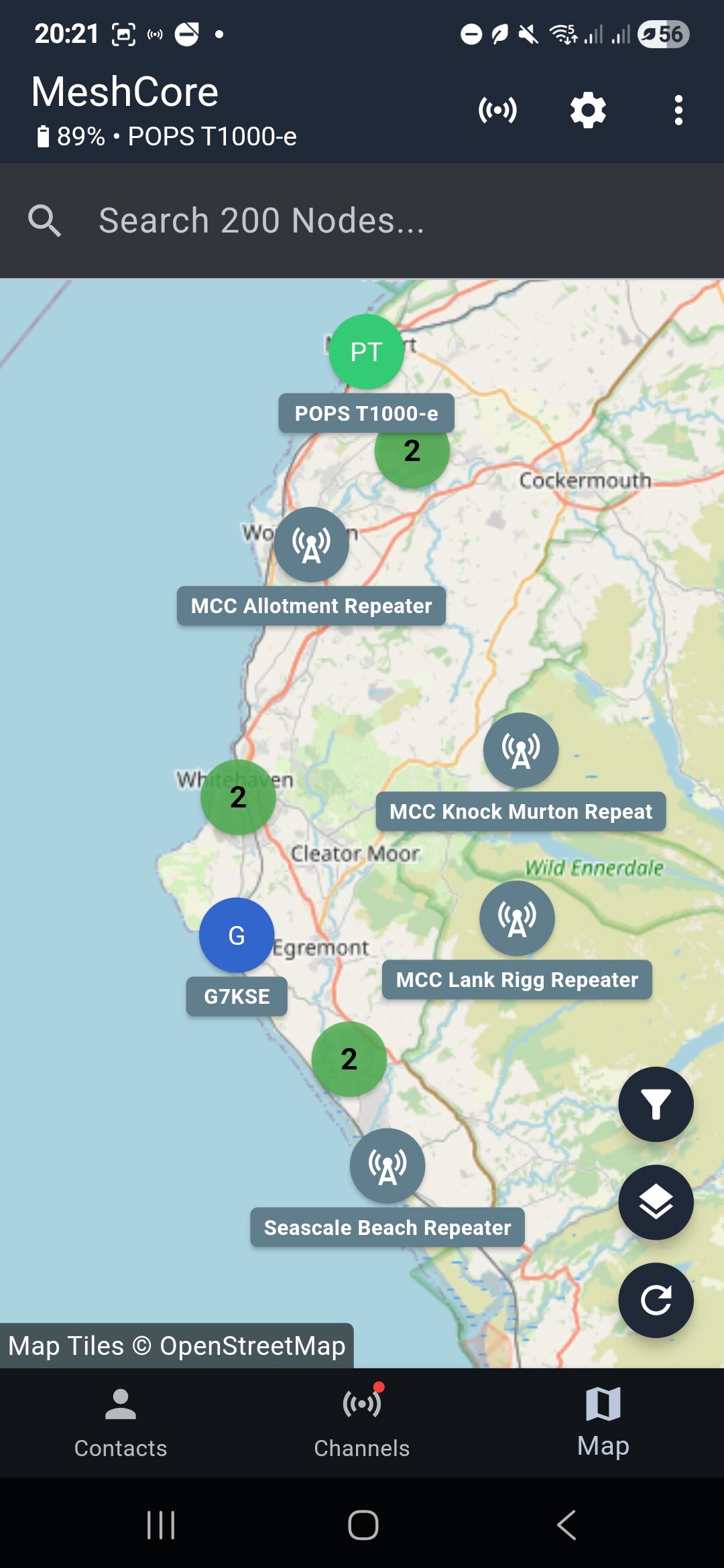

So far, I’ve got nodes up on the northwest side of Lank Rigg, the northwest side of Knock Murton, and the south side of Barnholm. We’re picking up a lot of traffic from down south, but it’s all one-way for now. There’s also a group over in Northern Ireland that I’m trying to connect to — that’s why I set up the Barnholm node — but it looks like we’re just out of reach at the moment.

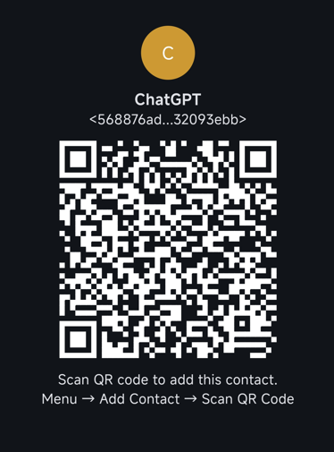

On top of that, I’ve set up (still very much a beta project) a node connected to ChatGPT, which lets anyone have a conversation with it over LoRa — even if they don’t have an internet connection themselves. If you’d like to give it a go, the link’s below.
That’s awsome that steve. Question how does the chat gpt work say if the full internet went out ? Wonder if you have seen them self hosted nodes ?

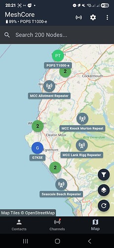

I’ve had a MC node running here and not had a peep out of it. Not an ideal location I know but today has had some amazing propagation and I’m seeing nodes down to Cornwall. Totally unreliable but interesting.
I’m loathed to have 2 unconnected systems as well as ‘normal’ RF. I’m happy to have hybrid solutions like matrix>MT or MC where the message is on my phone and gets passed to a LoRa device.
It’ll be a shame for either or both to have users invest in gear only for networks to be silent. MT suffers with that, just like some repeaters.

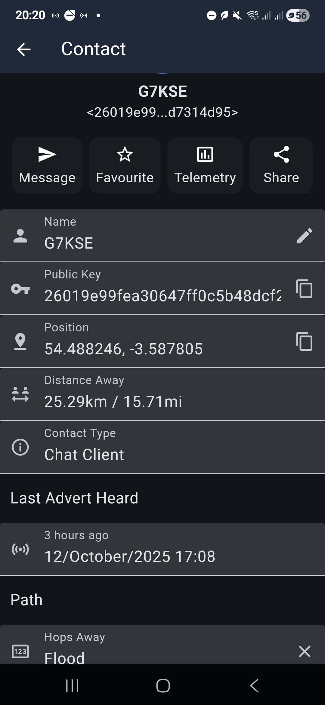

Hi alex. Make sure you put the node in narrow EU UK mode. Its best having a repeater and a client
@g7kse alex I see your node on the network
Ha ha, well the short answer is it wouldn’t. It was more a fun project rather than a functional tool. Although it’s handy for testing your connection. I suppose it wouldn’t take much to link it to a local run llm with a bit of tinkering.

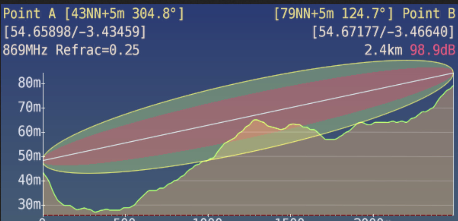

Yeah im going to have to have a look at switching the antenna, it’s just a little nubbin thing that sticks out about a thumbs length. I’m not a licenced radio operator but it’s something i’ve thought about doing for a few years. Ive spent a fair amount of time with SDR’s and long wires, but the technicalities of antennas is something that is still in the realms of witchcraft.
Thing is im not sure an omni directional antenna would be worth it where i currently am due to georgraphy and maybe a directional aiming towards ccq’s repeater might be the better idea.
Ive just done a plot between where i roughly am and where ccq’s meshcore node is, with my current location im in the valley above the river derwent:
One of the repeaters is in Broughton moor. The others workington and up the hills. Maybe a directional to either side might help. Omni from broughton cross might work the little antenna won’t do much. We have a radio club at workington and your more then welcome to attend you dont need to be licenced ham, lota is also radio. Its on tonight at 7pm till 9 ish at moorclose centre. If you want to come i can meet you outside as the room is hard to find
Forgot to say. Most of the location data on the map is not accurate somemof the nodes are not exactly where there shown.
Hi, thanks for the invite. I run a class on wednesday nights so i would have to try work out with my students a day change to be able to attend on Wednesdays. I’ll have a look at grabbing an omni, ive seen a 6db omni 868 online. See if i can bung it in the loft or onto the drainpipe or something.

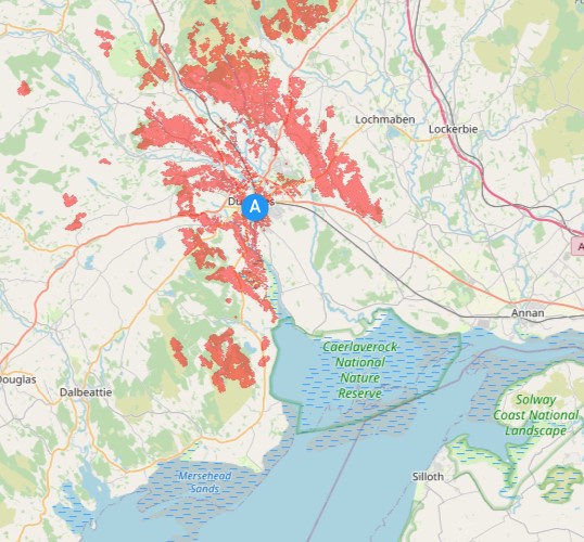

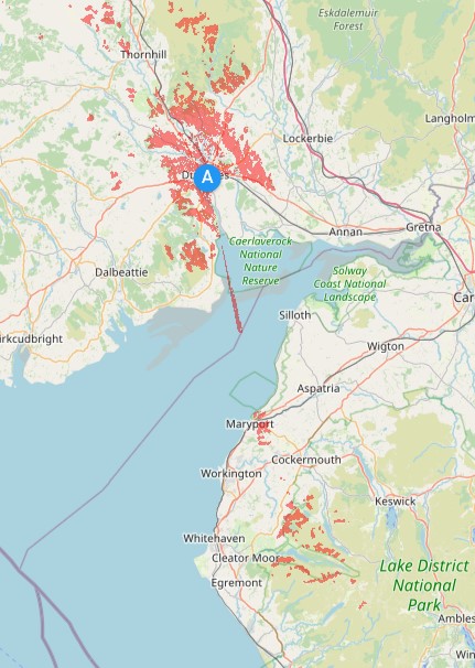

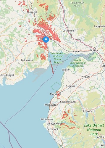

Well… living like a mole in a hole and surrounded by rather large hills, its going to be a struggle. I’m experimenting with a 12.5db yagi and rg8 feeder but its the hills that are really spoiling the tx/rx…. a couple of screen shots with the required antenna height above my hole.
antenna heights, 9 meters and 15 meters. (even the 15M mast gives a vey low signal into Cumbria, and any replies would have to shout very very loudly). I’ve been studying the maps and just cant see any single extra repeater doing the trick, at my last line of sights I would need at least 3 more (I’ve already spent the kids / wifes inheritance) anyway a Heltec V4 is on order which is capable of 1W output, not that I would ever ever use that amount of db’s, lol.
