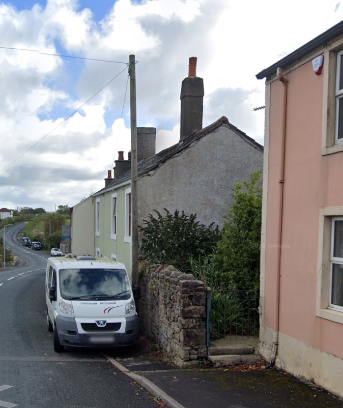

Heres a pic of the house. The green one. Currently the 6db omni is inside that upper window. Obviously doing pretty much nothing. Geographically the camera is looking directly from Workington side. The peach house is large and obscuring.

Ideally thered be a yagi attached to that large chimney pointing towards the camera, but that’s something I personally cannot do as i dont have ladders and im not sure the roof would take MY weight.

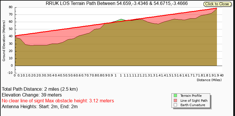

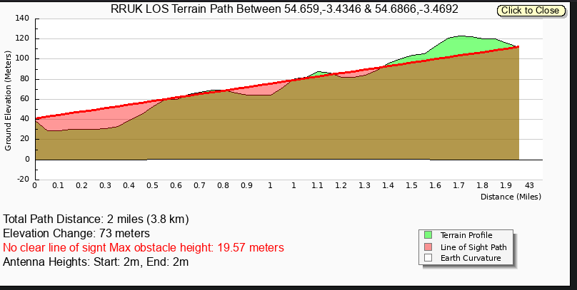

Using the UK Radio Line of Sight tools from my gaff to where i think the gentleman with the radio masts is in Broughton Moor i get the following graph
If its remotely close to where the nodes are on the meshcore map, its this:

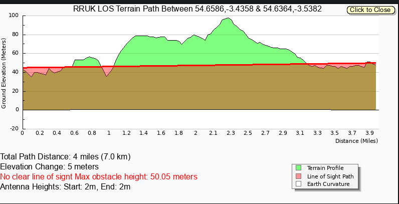

and to the allotment repeater its this:
I Think the only way i’d reliably reach the allotment would be a repeater somewhere near the school at GreatClifton

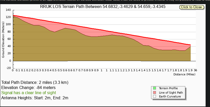

thats my LOS from my house to the big mast in broughton moor. i’ll see about getting a yagi ordered.
@M7NCY yeah what about the LOS to the repeater up on the moutain towards workington way ?

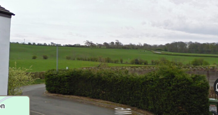

Ive looked at the topography and from my back garden where this image is from, you can see a ridge across the top of the fields(this is facing south), that location up there can pretty much see Knock Murton, so i’d have to guerilla a repeater up there somehow if we can’t make contact through the front, to broughton moor.
edit: additionally i can see the Broughton Moor antenna mast with my binoculars from my bedroom.
