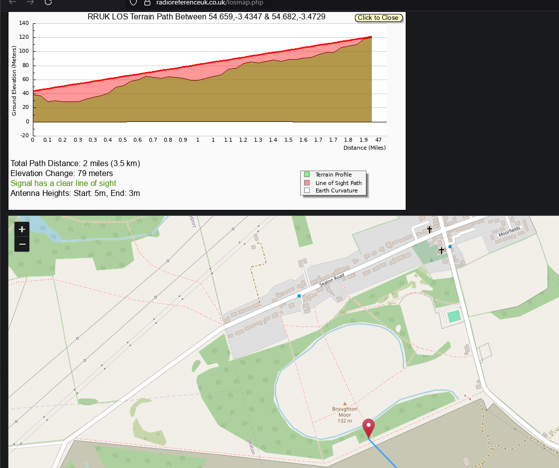

Yeah figured as much. I wonder if sending out a yagi signal that way would recieve anyway. I am recieving data from the Workington Allotment and the landscape to that radio is a lot worse than this.
What is this area on the map just near the transmit tower at Broughton Moor?
That whole area is LOS and if there was a solar repeater near we’d probably be golden. All of this is moot without me getting a yagi positioned though.

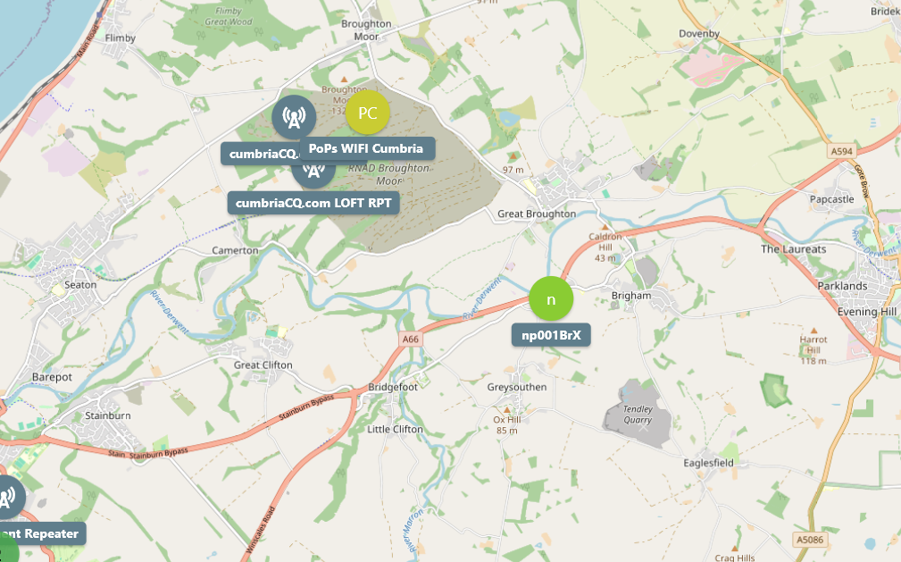

What is the node called you’ve set up? just to see if i can recieve it at all.
@M7NCY it wont matter what you pick up it will link into the mesh network.
cumbriaCQ.com RPT 1 and Loft Repeater you should see here.

The map i uploaded is where i am theres a field in the way higher than me
Maybe build a little solar repeater node and stick it in Broughton Moor Dumps?
I forgot to say @M7NCY you won’t get an instant ping on all of the nodes. They only alert every 12 hours. Your best putting a test message out on the public chat or the local chat using the qr code from https://meshcorecumbria.co.uk

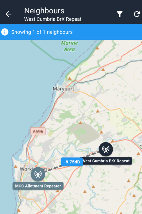

Ah i see. Yeah i’ll work out best way to get my current antenna outside ASAP. Be interesting to see if the Broughton Moor nodes pop up in the next few days. Interesting seeing the strength of the Allotment repeater considering what’s in the way.
yes if you can see that node you should see the rest. I think Steve said he was having issues with that node @Steve

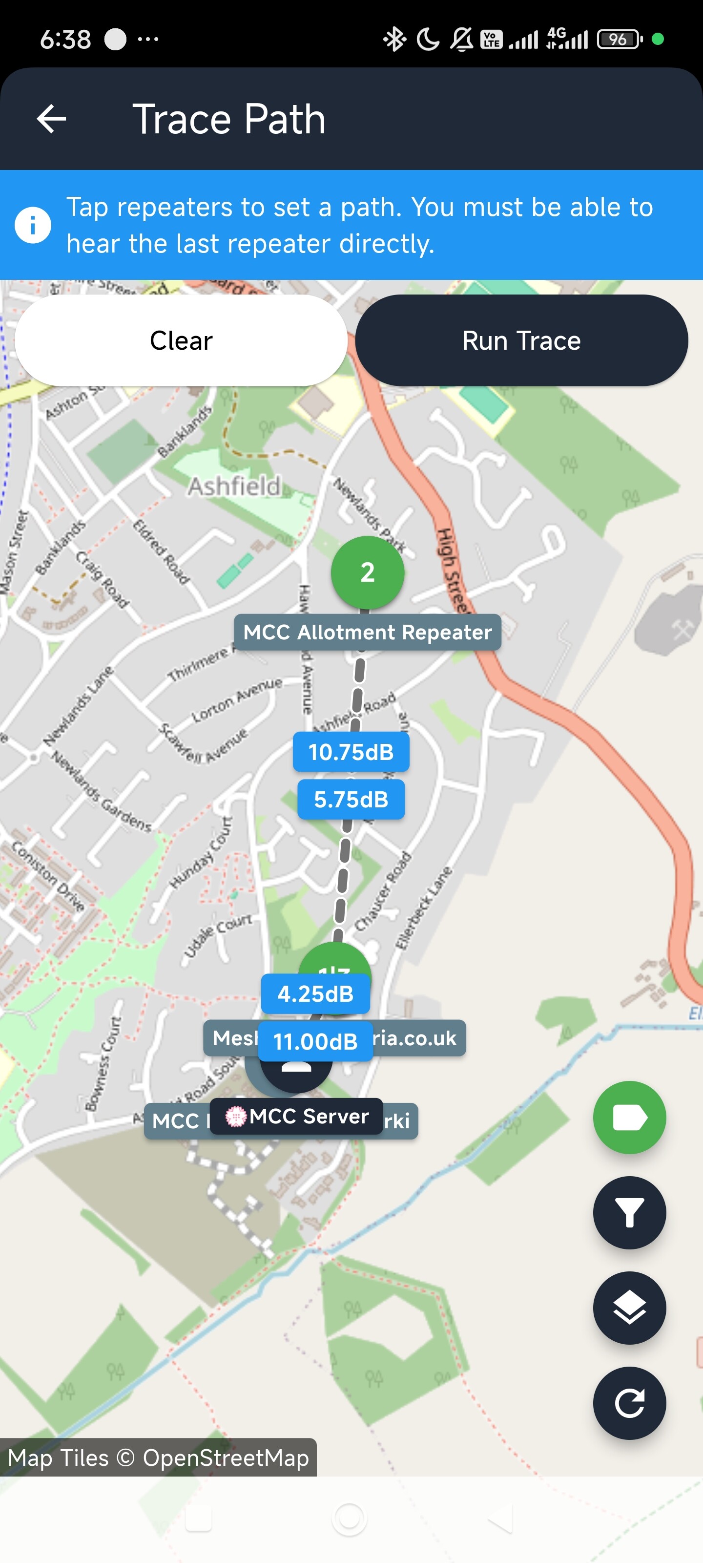

I’m having a bizarre issue with it atm. But it’s maybe a firmware bug I need to check with meshcore. If I run a trace route from meshcorecumbria node to MCC allotment is repeatedly fails. However if I ping the MCC allotment direct it seems to “wake it up” then trace routes work again (see image below). It’s my only node that behaves this way though.
I think this is what happened to mccpop kells i couldn’t ping it or Trace it. I also think if one of us is remoted into it reading telemetry the others cant get in or the session never ends.
I woke up today at 3am and I tried the remote ping etc and it all worked I could access all the nodes telemetry etc. Maybe someone was logged in when you were doing ping tests.
Try it again at 3am lol
That’s really odd. I can login and trace route to it again now. And MCC allotment seems to have settled down too. Maybe there was whatever the reverse of a lift is happening for me yesterday. Haha.

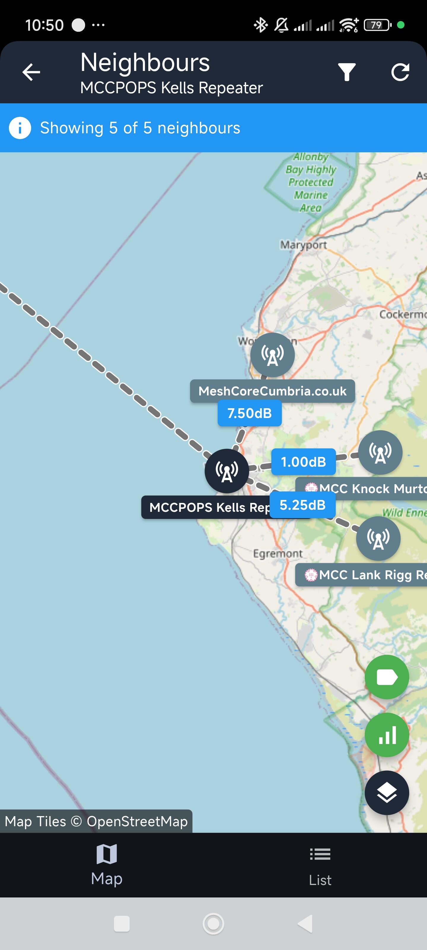

Looks like Kells has a pretty decent connection out to 4 nodes so far!

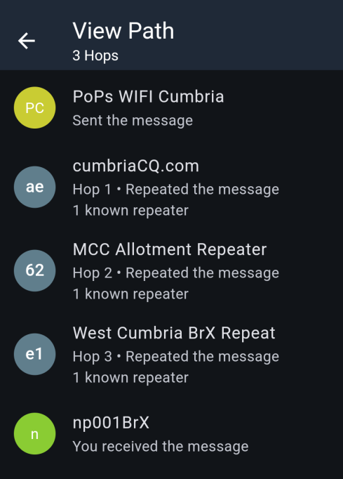

@M7NCY i can see your node on the mesh network now
I got your message through @M5LEE I was out and about in workington earlier with my companion radio. I recieved your message in the public channel with the following routing you probably picked me up while i was in town, and the message got to me while i was home. so i can pick up the allotment periodically. be probably a week or longer before i can get my antenna positioned more favourably.
Yes I picked you up. Works great round workington. I doubt we will get a link from you to here but there’s new nodes going up all over the place. Im going to put Lens new repeater up in Whitehaven soon as it comes. Right on top of moresby
