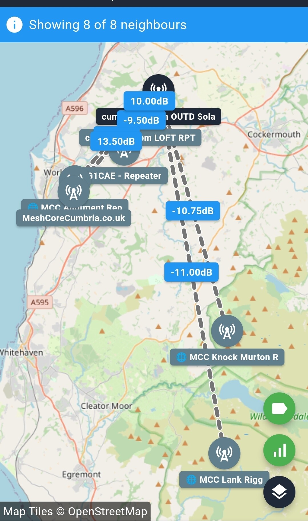

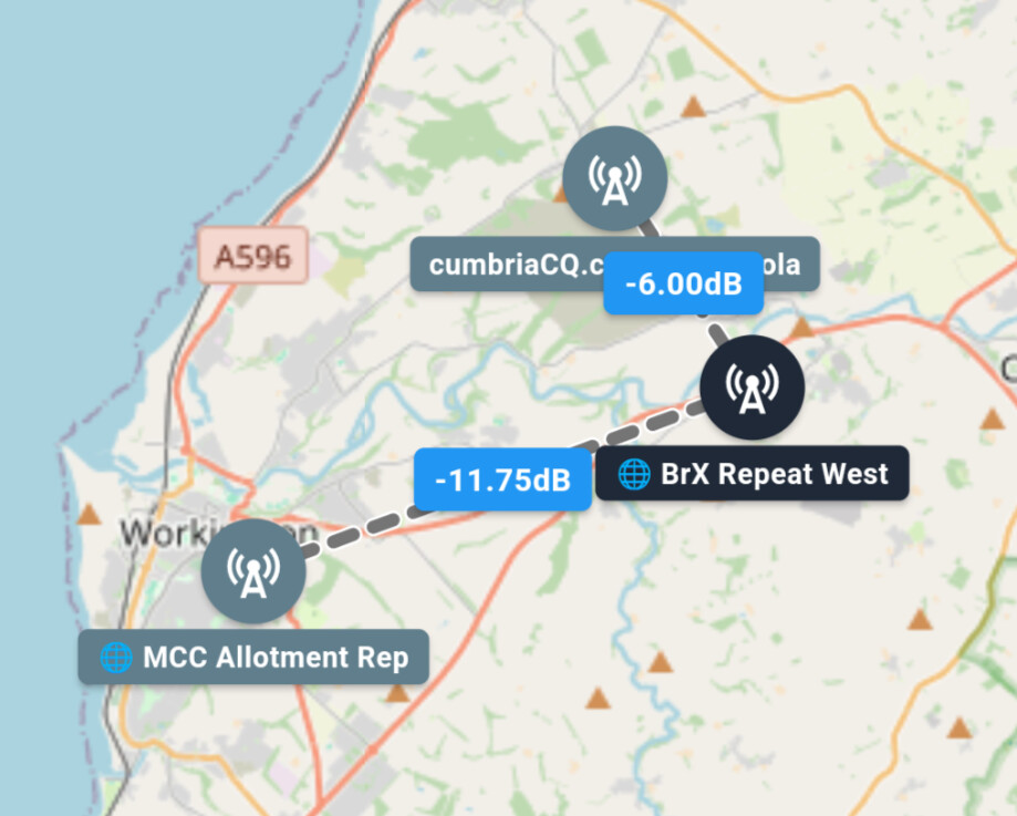

it picked up throughout the day. Lee if you get chance, can you log into your solar repeater and in settings, check the neighbours page and if possible take a screenshot of that for me please? Interested to see what db levels you’re getting to different nodes.
I dont see yours

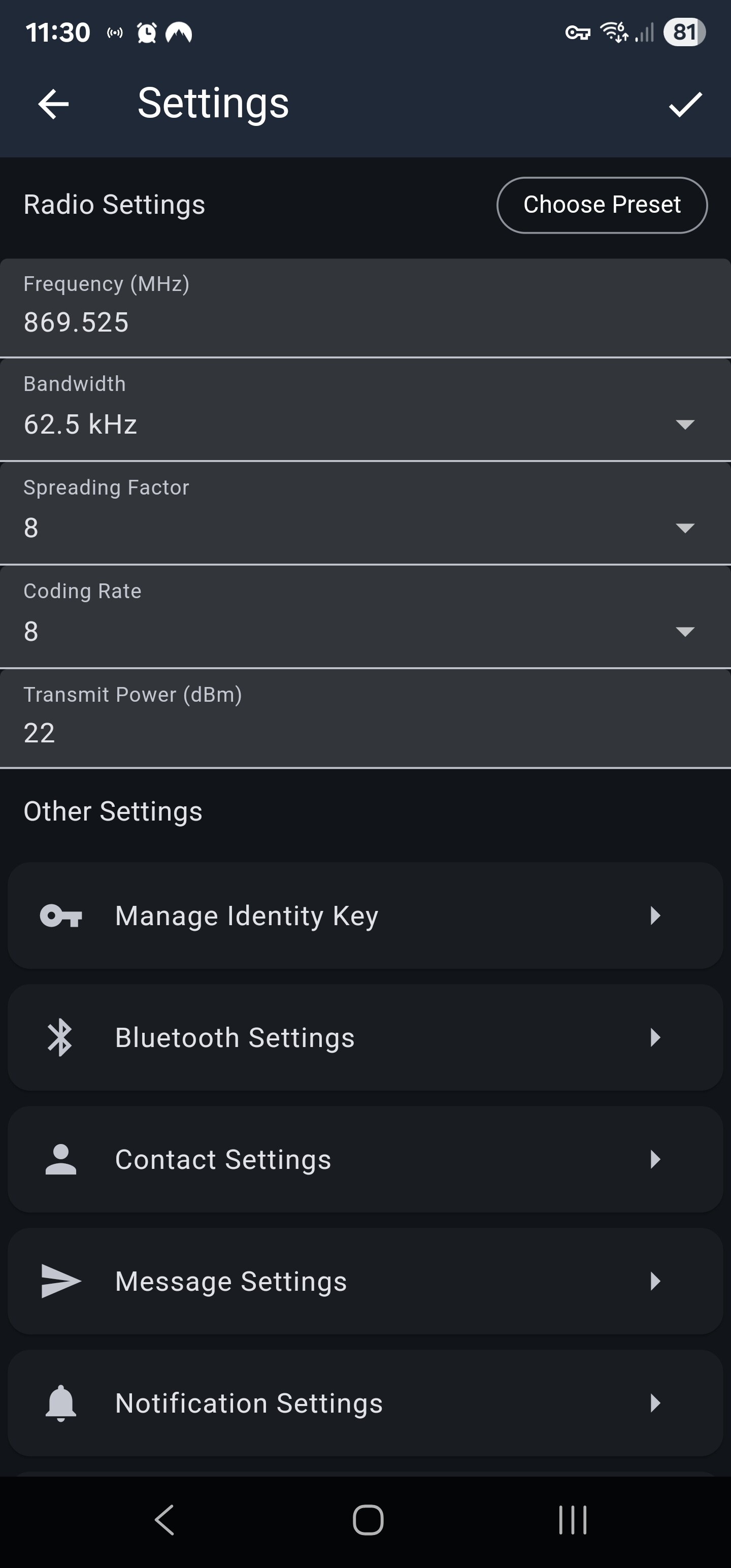

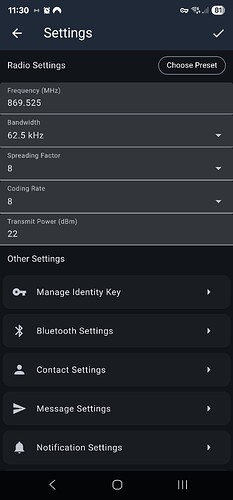

On the Meshcore map, it shows the nodes in Carlisle using a different bandwidth, SF and coding rate to everyone else in Cumbria.
I’ve set mine too:

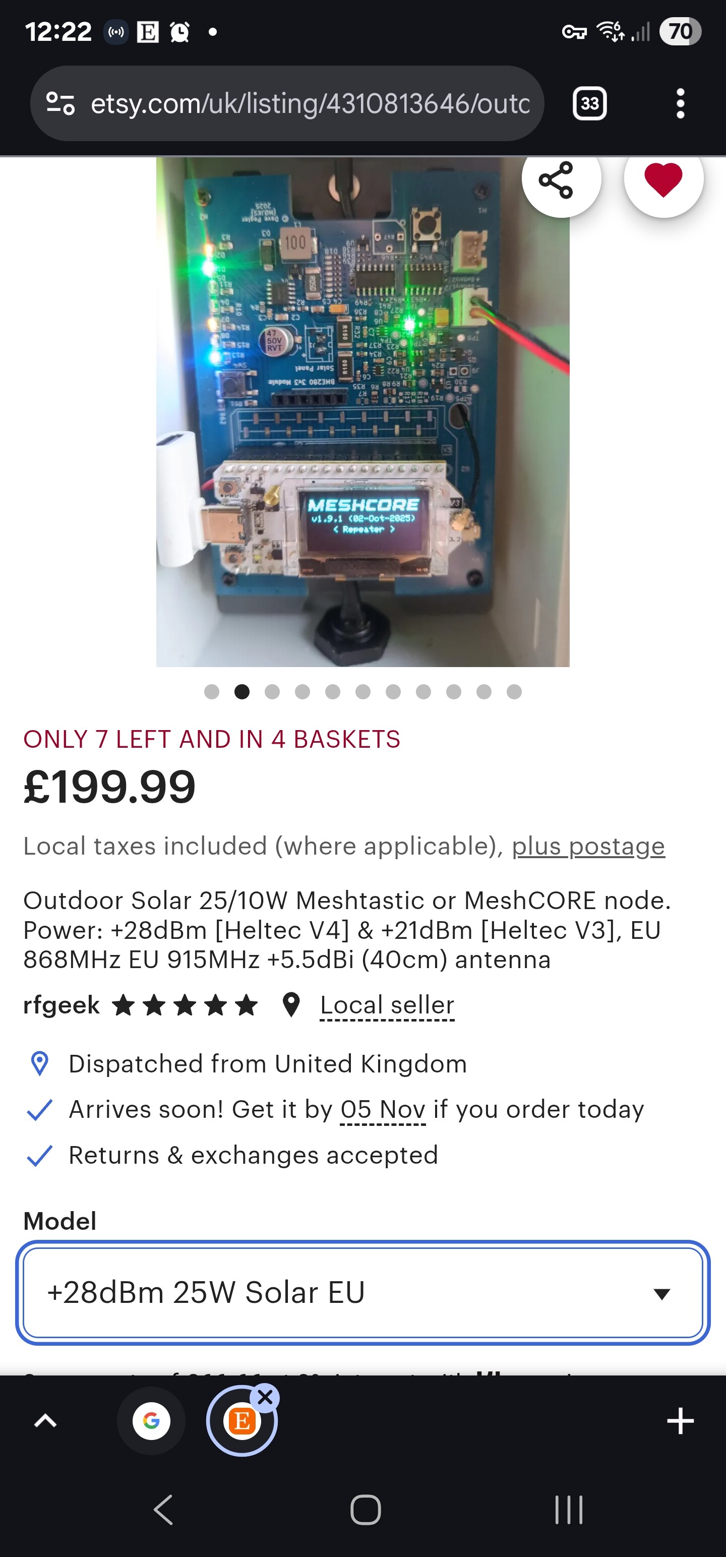

RFgeek is now putting V4s into his prebuilt nodes.
https://www.etsy.com/uk/shop/rfgeek
I’ve just ordered myself a v4 with solar panel.

That frequency is wrong @Dani theres a preset in the menu. Change it to UK/EU Narrow. The frequency changed a few months ago. Try that. Im building 2 yagis 1 to point north towards Carlisle and one East maybe. Just waiting on parts coming and time to build them :slight_smile:
No worries. You will get there.
Changed the settings, thanks.
